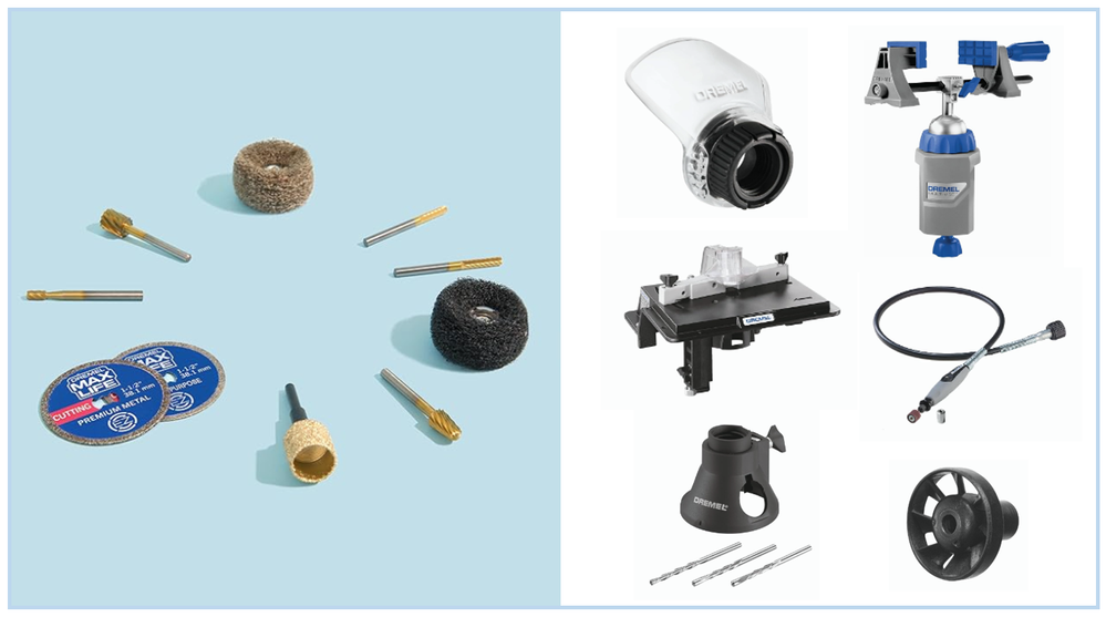

Rotary tool attachments are part of the system of options that can adjust and alter the function of the rotary tool so it can perform a specific application such as sharpen a chainsaw or remove grout. Attachments do just that, they attach to the rotary tool, usually by screwing onto the threaded part of the tool that lies beneath the nose cap.
Some of the attachments that are available for rotary tools include:
Drill press (Workstation), flexible shaft for carving, router table, router base, cutting guide, grout removal, right angle, lawn mower blade sharpener, chain saw blade sharpener, circle cutter, straight edge cutter, and a multi-position project vice.
Rotary Tool Accessories
Rotary tool accessories are part of the system of options that can adjust and alter the function of the rotary tool so it can perform a wide variety of applications on a variety of materials. Accessories are inserted into the rotary tool itself, and held in place by the collet, and collet nut.
Keeping all of the accessories for the rotary tool straight can sometimes be challenging. To simplify, think about them in terms of what can be done with them and how useful they really are.
Accessory bits are classified by shank size, grit material, and the shape or size of the head on the shank. For example, an accessory has a 1/8” shank, aluminum oxide grinding stone, with a 5/8” head. Most of the accessories for rotary tools have a 1/8” shank diameter. Other shank diameters include: 3/32”, 1/16”, and 1/32”.
Speed ratings dictate the successful use and longevity of any accessory. With the exception of rotary brushes, grout removal bits and finishing abrasive buffs, most rotary tool accessories are rated for 35,000 rpm. Brushes and abrasive buffs should never exceed 15,000 rpm, as the brush's bristles will bend and break, and the buffs will fly apart. Grout removal bit should not exceed 20,000 rpm, as the heat will wear the accessory out very quickly.
