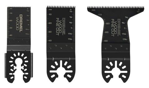

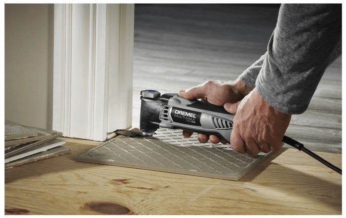

Flush-cutting
Multi-Max_Red_FlushCutting.jpgThe ability to make flush-cuts and plunge cuts comes in handy when you need to trim off dowels when making furniture, trim an obstruction while installing flooring, or make cuts in tight spaces. Flush cut blades have teeth aligned in a straight row.
Flush cutting blades include models: MM100W-1, MM105W-1, MM200W-1, MM205W-1, MM220W-1, MM300W-1, MM422, MM422U, MM462, MM462U, MM473U, MM474U, MM476U, MM480, MM480U, MM482, MM482U, MM485, MM485U, MM494, MM494U

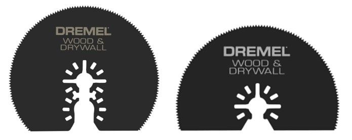

Drywall-cutting
Drywall cutting blades have two separate configurations: teeth aligned on an arc and teeth aligned in a straight row.
Drywall blades
Multi-Max_Red_Drywall.jpgModel MM450, MM450U, and MM452 have teeth aligned on an arc and are designed to make straight cuts. MM450 and MM450U are high carbon steel blades that are designed to cut both drywall, plaster, lath, and wood. Model MM452 is a BiMetal blade that is designed to cut drywall, plaster, lath, wood and soft metals.
