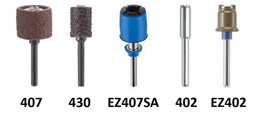

Mandrels
Before we discuss sanding accessories, let’s take a moment to discuss mandrels. Dremel has two different mandrels for ½-inch sanding bands– the mandrel that is included with the 407 sanding band and the EZ407SA mandrel. Dremel has one mandrel for 1/4-inch sanding bands– the mandrel that is included with the 430 sanding band. The 430 and 407 mandrels require a screwdriver to tighten the screw that secures the sanding band to the mandrel. The EZ407SA mandrel uses a tool-free mechanism to secure the sanding band to the mandrel. Finishing abrasive buffs and detail abrasive brushes may be used with the EZ402 EZ Lock mandrel or standard 402 mandrel.

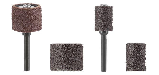

Sanding drums and bands
Common uses for sanding bands include smoothing and shaping wood or removing paint. The sanding drum can be thought of as the mandrel that holds the replaceable sanding bands. There are two sizes of sanding drums: the 407 and 430 drums use a screw to release and tighten the sanding band and the EZ407 drum uses a tool-free method to release and tighten the sanding band. The sanding bands that fit the ½” 407 drum, ¼” 430 drum and the ½” EZ407 drum are available in 60, 120 and 240 grits.
Model numbers include: 407, 408, 432, 445, 430, 431, 438, 446

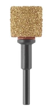

Max Life Carbide Sanding Drum
The Dremel Max Life 408HP 60 Grit Carbide Sanding Drum has a carbide coating that provides added durability to the surface of the drum and will not tear loose like other ordinary sanding bands. It features a 30X longer life compared to the Dremel 408 sanding band. It’s ideal for a variety of materials including ceramic wall tile, hard & soft woods, pet nails, composites, fiberglass, MDF boards, rigid foam, gourds and more. Includes one 1/2 In. (12.7mm) coarse 60 grit carbide coated sanding drum.
Model number: 408HP

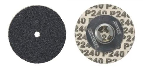

Sanding Discs
Sanding discs have a finer grit than sanding bands and provide a flexible surface that allows sanding in contoured and hard to reach areas. There are two styles of sanding discs: those that fit the 402 mandrel and those that fit the EZ402 mandrel. The discs that fit the 402 mandrel have a ¾” diameter and are available in 180, 220 and 240 grits. The discs that fit the EZ402 mandrel have a 1-1/4” diameter and are available in 60, 120 and 240 grits. Sanding discs work well on wood and fiberglass materials.
Model numbers include: 411, 412, 413, EZ411SA, EZ412SA, EZ413SA

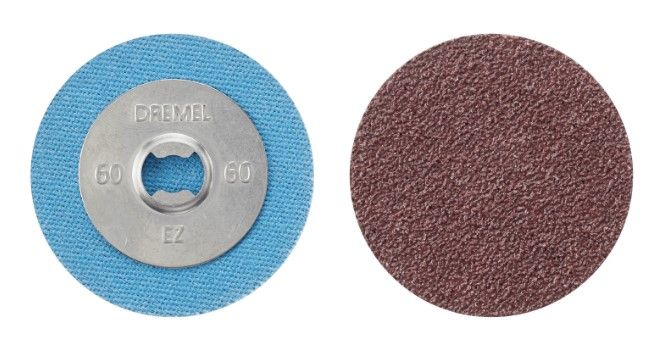

Max Life Sanding Discs
The EZ411HP Max Life sanding disc features a 44% larger sanding disc vs the EZ411SA allowing the 60 grit sanding discs to remove material quicker and more efficiently. It’s hard and long-lasting aluminum oxide abrasive lasts 20X longer life compared to Dremel EZ411SA sanding disc. The disc can be used on wood, plastic, soft stones, drywall, rubber, metal, and more. Includes three 1-1/2" (38.1mm) diameter sanding discs. Compatible with EZ402 EZ Lock mandrel.
Model number: EZ411HP

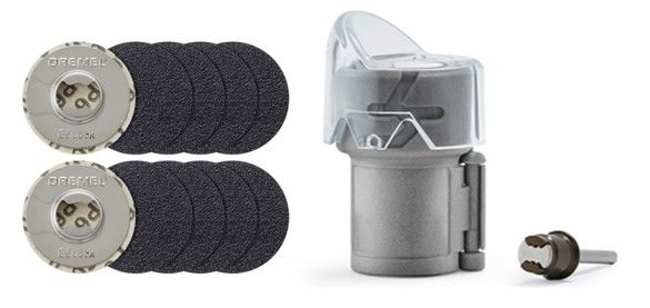

Pet Grooming Disc
PurplePetDisc.jpgGroom your pet from the comfort of your own home with Dremel pet nail grooming solutions. Ensure your dog or cat's nails are freshly trimmed with the SD60PGK Pet Nail Grooming Sanding Discs. The sanding discs can be used to gently grind, smooth, and shape your pet's nails and clean up rough nail edges. Designed to be used with the Pet Grooming Nail Guard Attachment (not included). The replaceable 60 grit grooming discs fit the Dremel EZ Lock™ mandrel to make changing grooming discs quick & easy. Includes 10 EZ Lock Pet Nail Grooming Sanding Discs.
Model number: SD60PGK

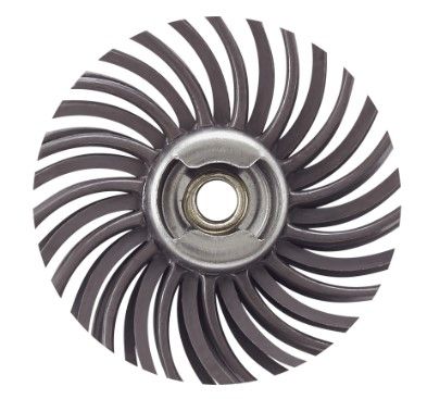

Detail Abrasive Brushes
Great for detail cleaning and light sanding and allows sanding of contours, details, and hard-to-reach areas. The rubber bristles have abrasive inside, so there is no need for polishing compound. Detail abrasive brushes remove the exterior surface layer without damage to base layer below and removes the paint but not the wood with light pressure. Use on metal, wood, glass, aluminum and plastics. EZ471SA is 36 grit. EZ472SA is 120 grit. EZ473SA is 220 grit. For use with the EZ402 EZ Lock Mandrel or Standard 402 Mandrel.
Model numbers include: EZ471SA, EZ472SA, EZ473SA
