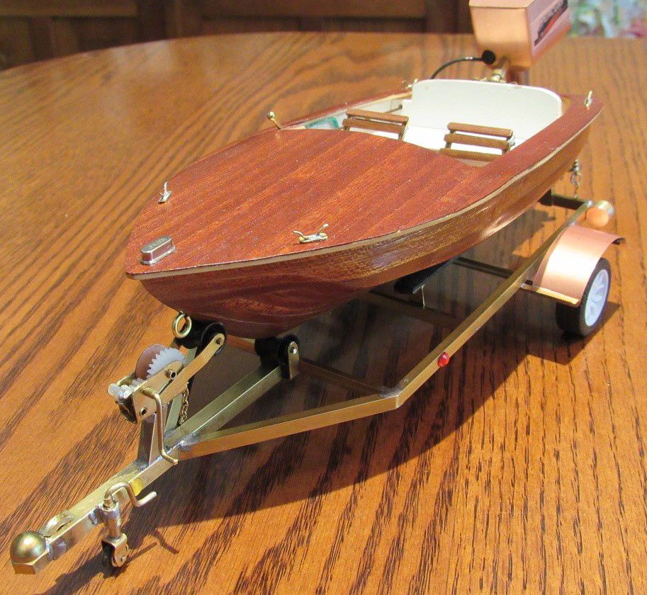

I have always wanted to make a working outboard motor and finally got one started. It was more of a challenge than I had thought it would be. Finding a tiny electric motor to go inside and then coming up with gearing to slow the RPM's and to fit into the lower unit was a feat to be reckoned with. Then making the boat made making the motor seem easy. I had to design ribs from the stern transom to the bow and then to plank them in compound curves. All the while trying to incorporate a steering mechanism, a tilt plate for the motor and a place to hide the battery. I used every tool in my Dremel arsenal. My moto-tool & drill press, my moto-saw, my router table and my versa tool. The boat is made of 1/16" hobby ply and covered with walnut veneer. Decorations on the boat are electronic components from circuit boards and deck cleats that I made myself. The motor is made from copper sheeting soldered together and the trailer is primarily from brass tubing of various sorts. It took a little over 300 hours to design and fabricate the parts and to get them all to work properly. It was fun and educational and I think it looks really nice.Motor bracket parts
Completed motor bracket
Basic outboard plan
hand made propeller
Steering mechanism
Hull veneer
Laying out ribs
Trailer frame
Finished front view
Finished side view
Finished rear view

Wow, that looks great. It is so detailed and looks very authentic.
Thanks for sharing your photos.😎
