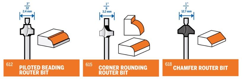

Piloted bits
OrangePilotBits.jpgNote: Piloted routing bits are designed to work on the edge of the wood and not down the center of the wood. Dremel piloted bits are the 612, 615 and 618.

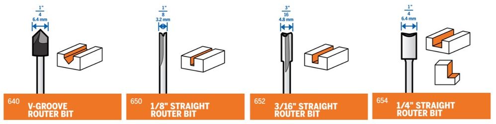

Straight bits
OrangeStraightBits.jpgStraight, and V-groove bits work well for routing down the center or interior of a piece of wood. Dremel straight bits are the 650, 652, and 654.
Project: You can create a picture frame by using a plain piece of wood and adding a decorative edge with a 612, 615, or 618 router bit. Using a straight bit like 650, 652, or 654, you can rout-out the center of the wood to create the picture area of the frame.
