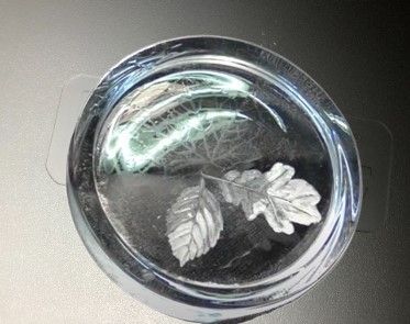

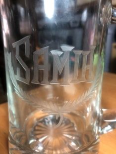

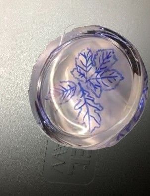

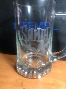

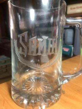

Personalized Beer Mug  (My Name) and Round Coaster
Remarks on these projects:
1- You won’t have to press hard to make an engraving onto the surface of the glass.
2- Higher RPMs might crack or damage the glass.
3- The Dremel Glass Etching set contains 8 glass engraving accessories, including silicon carbide grinding stones and diamond wheel points.  A diamond-tipped is better for precise and sharp engraving and etching and straight edges while silicon carbide tips are better for shading or filling in areas.
4- Drip some water from a pipette onto your design area and engrave through the water, this will keep the dust down and give you a slightly different effect.
5- Before you start to engrave, ensure that you are wearing safety goggles and a dust mask as the glass particles are small and hazardous if breathed in.  It is also recommended to wear second skin gloves as this will protect your hands if the Stylo+ or flex shaft slips and also to assist with gripping the glass.
