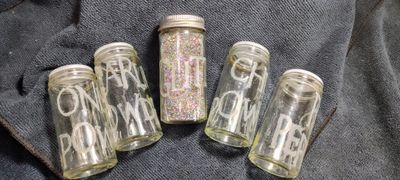

I etched my spice jars, and one i keep glitter in! I mostly used my Stylo+ with diamond bits. I can't find the video that shows this. They aren't perfect, but I'm proud!

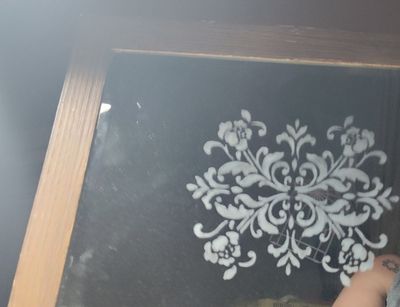

So far I have not had any problems, knock on wood. I print out my design and i use those purple dissapearing, washable glue sticks to stick it to the inside. When i'm done I just take it out/off and wash it out. I've done vases the other night i did a mirror on a wooden box, I did this for my mom, it's dragon eyes, and it's pretty thin. I make sure I'm wearing safety glasses and at gloves, it is a fine dust. I never thought about the vibrations at all. I do stuff towels or some type of cloth in it, if I can, just because of the noise it makes, or I have it laying on a towel. I'll post a picture of one of the first vases I did too.

Here's a mirror on a wooden box I did the other night. I used a stencil for that one, or I use carbon paper to trace the image. I use my Stylp+ for etching. The size and weight is perfect. I have tried with with my multi flex, I have a hard time with the way I bend my wrist when I etch. Look who had to photo bomb! Mr 8220! He was sanding something and needs to be cleaned up! This vase was one of the first I did. I painted the gemini devil/angel but I could never get the white to look as smooth as the red did. I did one for my Mom for Mother's day where I etched a lot of words on it , then filled it with different colored sand. I'll get her to send me pictures so I can share them. look who photo bombed!
