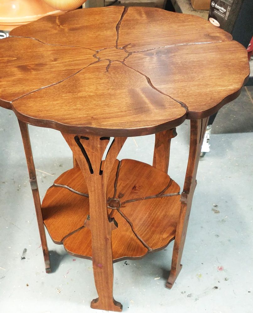

That's beautiful!
Dremel-Peggy
Beautiful table, nice work johnbaker.
