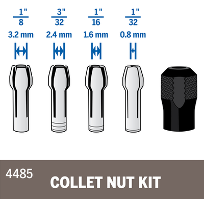

The Collet & Nut Set Here:  4485 Information Here
In this kit there is a 1/32" collet for the 1/32" bit.

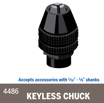

We also have the Dremel Chuck 4486:  4486 Information Here
The chuck can hold bits that have a shank size of 1/32" up to 1/8".
